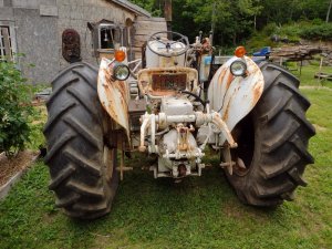

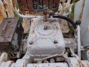

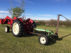

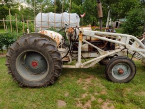

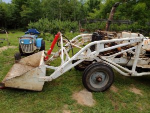

That is most likely what I will do, drain and replace. This was built in Ontario, we have the hood off now, replaced water pump and had the radiator repaired. 4 Cylinder Continental engine, starts almost on first click of the switch.

Thx, that was a Cockshutt 40 and an Oliver built mower... all the older round nose models were built in the same plant as your 540... Ive been looking for a 20 but they always seem overpriced... I dont have much need to a bigger tractor but I would like to restore one just because Pop had the service center... I still have one of the door signs off his old service truck.

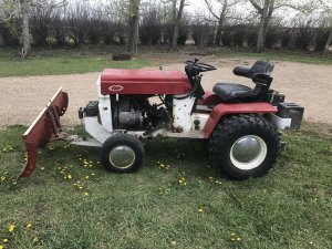

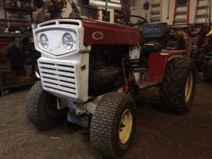

My MTD looks similar to the 990 but it is a 960 with a 4 spd and 12" rear wheels... all the canadian built models had flat rear fender similar to the 990 and they also have a differant grill... it doesnt ride as nice as the 990 but it does pull better ;)
I have a 960 with 4 speed, rebuilding the motor now, 16 HP single cylinder B&S cat iron. The 960 is the tractor I haul my wood out with. Yard them out full length then buck them up. Nice old sign, love the early advertising tin signs.
