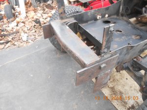

I found a set of prints online for a 322 weight bracket and that's what I needed to start one for the 316. Nice part is that is will also fit my 1974 112. It's gonna take some noodling as I would like to incorporate the brush guard I made some time back. That I would like to lay down flat also for a tote of sorts. Supposed to rain tomorrow, so I'm open to ideas/suggestions. So far, I have built the outside brackets. I found a pair of spring latches and they should be here Thursday.
https://www.amazon.com/Buyers-Produ...5932&sr=8-16&keywords=heavy+duty+spring+latch

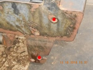

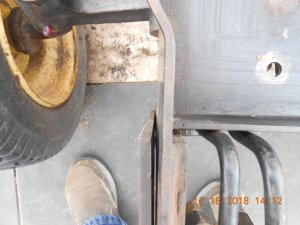

Anyways, on to the pics. Here is where the brackets will mount, using the holes with red dots.

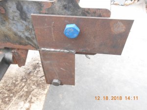

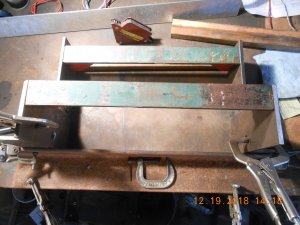

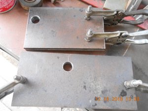

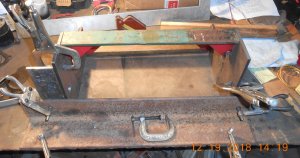

I got all the measurement for hole location and cut some 1/4" X 3.4 pieces. I clamped the LH & RH parts together to drill the holes, then beveled where the welds would go. Welded them together, came out pretty flat.

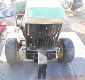

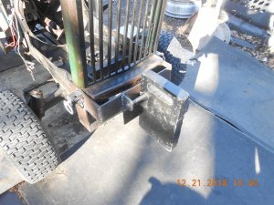

Here's both brackets on the tractor.

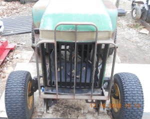

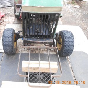

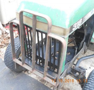

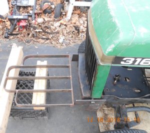

And here's the brush guard.
Now to figure out what's needed there and what's needed to use my lead suitcase weights. Also here's a bracket on the 112.
I need to cut clearance for the bolt in behind the bracket, no bolts sticking out on the 316.

The more I think about it, I'm going to make another set of brackets for the 112 and put the brush guard/tote on it. This set for the 316 will be for suitcase weights. I'll set it up for all 4 that I have at the moment. That would put 160 lbs up there! Doubt I'll need that much weight. 2 (80 lbs) is usually enough.

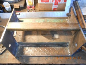

The voices in my head tell me to change out that upper spreader to a piece of angle iron. Better chance of it not warping as I weld it.
Indeed an angle would be better otherwise the structure will not be as sturdy but the tractor's frame would help on that once mounted.
Will you make V grooves where you will lay your welds?

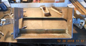

Yes I do make beveled ends and such. Not as pretty with the arc welder, but mig gas is running low. I used a piece of about 3" strap across the front and the 1.25" to make an angle for the front top. Mounted the other separator down at the lower end and it didn't warp out of shape.

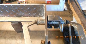

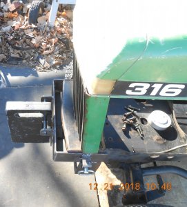

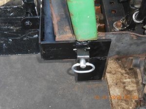

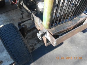

Got the spring latches in. They came in an oversize box.

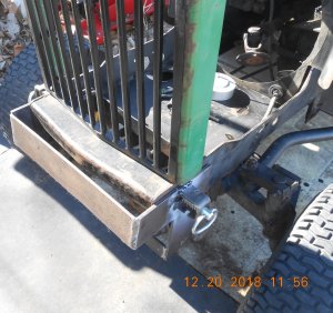

Got them attached.
Time for a test fit!
All is good! Now to make up the weight holder!
