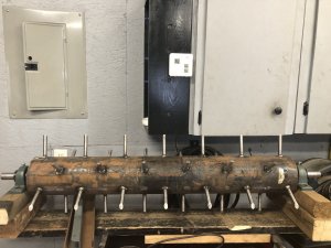

Started a aerator to use next summer behind the Massey 1655. Schedule 120 pipe filled with concrete with 4 inch long 5/8 diameter spikes.

Works good....tried it on semi-frozen ground lol....Probably put some 1/8” plate (oil tank) on the top for extra weight if needed but I doubt it’ll need it. Still needs a second coat.
