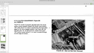

I found the manuals for the tractor and did some searching and found that the clutch can be adjusted. I took a screen shot of the page and sent it to him. Also found that the clutch can be relined.
