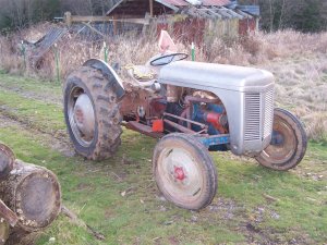

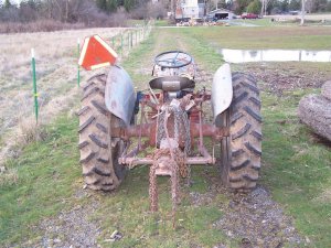

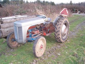

Got this Ferguson yesterday at the same place we picked up a Yanmar. I don't know what model it is yet. I'll check the tag today. Its been sitting for years, but in a shed so it should be decent shape.

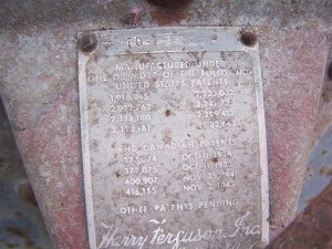

Just looked at the tag and it is a TO and the serial # 14558 looks like a 1949 TO-20 if I'm reading things right.

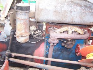

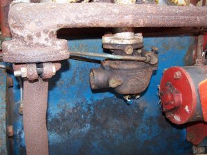

It should be a runner after we get the fuel system cleaned up, new battery, and change the points and condenser. My dad did some engine work years ago on this tractor. He bored the block for some larger sleeve's that the owner had picked up that didn't fit his block. There shouldn't be too many hours on it after it was rebuilt, but I do worry that it is missing the air cleaner to carb tube. I hope he just pulled it off and wasn't running it that way.

Surely he didn't run it without the air filter connected. These Furgs look so much like the Ford 8n.

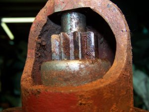

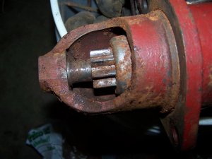

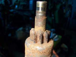

Had the charger on the battery overnight. It had enough juice to spin the starter, but the bendix drive wouldn't engage. Pulled the starter out and found light rust on the shaft which I cleaned off and got the bendix working freely. Still need to install and test. After charging the battery again I did a load test and it looks like it needs a new battery. I also pumped up all of the tires and found the cores are leaking in the rears which appear to have calcium in them. We always have some cores on hand so it should be an easy fix. I turned the fuel on and got a bunch of crud in the sediment bowl and the carb leaked so they will need to be pulled and cleaned. I'm making some progress.

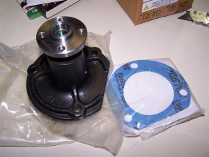

I forgot to add that it looks like the tractor needs a new water pump. It actually started leaking when we first looked at it. I rolled the engine over to see if it was stuck or not and it started dripping antifreeze. I was hoping after running it some that it would stop, no such luck. The generator wasn't hooked up and it had a 12 volt battery in it so we will be installing an alternator.
Some of those had a grease nipple on the water pump. You should have a look for that.
