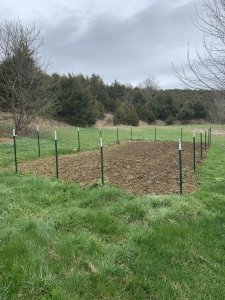

Our second garden 25x48 we started two years ago was basically a loss last year. We just grew corn and potatoes in that one. We fenced it with tee posts and the vinyl mesh fabric to keep the deer and rabbits out. For the coons it was just a ladder to the corn. We also had a storm that bent over two rows and they never recovered.
I’ve been shopping around for some electric wire to put around this. I’m thinking a double wire one mid way and one near the top. Any suggestions on the brand or placement of the wire would help. Thanks

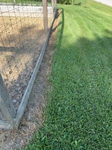

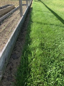

Like Tahoe said, use several runs of the wire. To be fully effictive have to keep the grass off the wire. Bottom one about 3" up. I use 24" chicken wire and have good luck keeping all critters out. I also use several CD's on a loop of wire hung from a run of heavier wire along two side of the garden. The slightest movement of the CD will reflect light from the moon, etc. Keep the ground sprayed with MaKaze (vegetation killer) so the fence can be rolled up easily. Can get the spools of light weight fence wire reasonable. If I remember right about a mile of wire per spool.

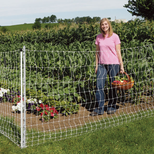

This is what you need. ELECTRIC NETTING. Hooked up to a 2-Joule or higher energizer. (not the bunny).
This is all we ever use. If you have high-winds, get the double spike so the wind will not blow them down.

Everything inside has never been touch by critters nor deer since the electrified netting has been in place.
