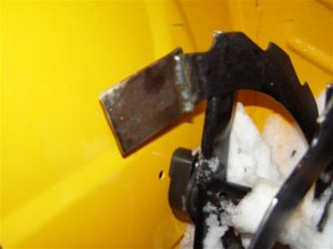

Ever since I bought this Poulan in certain conditions it would always push a little bit out on the cleared side.I made some 3"x 2" extensions to weld on the outboard ends of the flights so it's only about 1/2" from the housing. Have tried it a couple of times and it works good to eliminate that little wrinkle of snow. A little thing but it's always bugged me.
