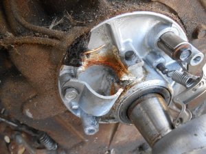

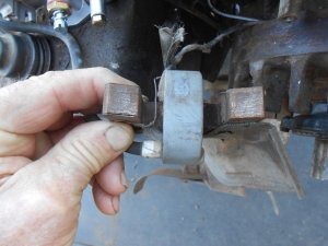

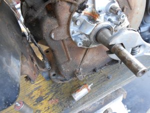

Got back into these engines today (have 2). First one got a new condenser and flywheel key. Fired right up and ran fine. Second one needed more, condenser was rusty/nasty. Think the carb is not working right, damn pulsa-jet!
