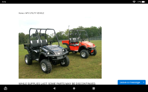

Can't say I ever heard anything about them . Do they look similar to these ?
