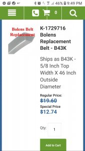

Roger I checked my invoice to see what I bought. It's showing the belt 46" where did you get 47" as the length. Here's what I got.

Length is 46.6" width is 43/64" (HB), Thickness is 7/16". It's wider than a standard A series or 4L belt and a 5/8" or B series belt is too wide and too thick. You may try a 1/2 x 46" or 1/2 x 47", but in the end you may well be better off finding a NOS Bolens belt for it.
