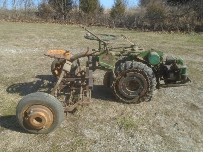

Over the years, I have owned 5 of these garden tractors.
I have sold all of the others and this is the last one that I have.
The guy that I had bought this from, around 10 years ago, was still using it to work his garden every spring.
I have left this tractor un-restored and it still looks just like it did when I first got it.

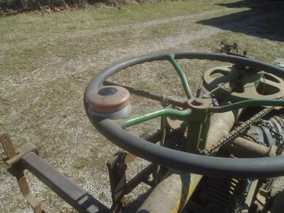

It has a couple of added accessories that you don't find on these Ridemaster tractors.
The first is the steering wheel spinner. It is a rather unique design that I have never seen before.

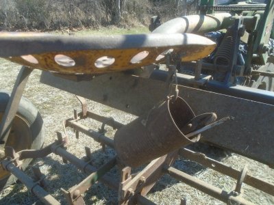

The second accessory, and my favorite, is the carefully handcrafted, farmer installed tool can ingeniously mounted under the seat.

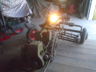

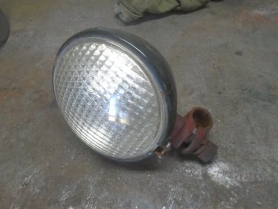

To go along with these two accessories, I want to mount a headlight on the tractor.

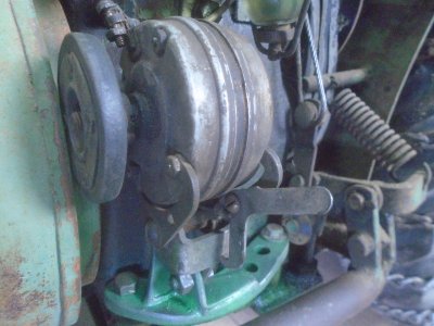

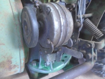

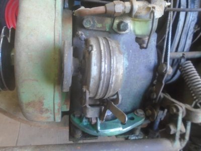

I don't know what the small generator came off from that I used on that tractor. I decided that I wanted to put a light kit on this last Ridemaster that I have so I went looking for a small generator and found one off an old Whizzer motorbike.
As you can see, it has the patina that will go well with the condition of the tractor.

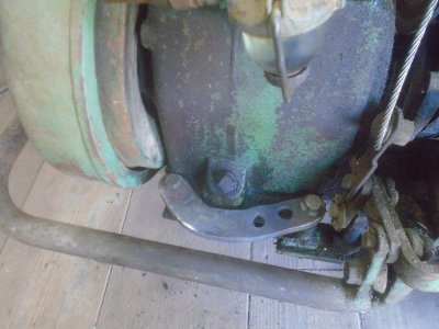

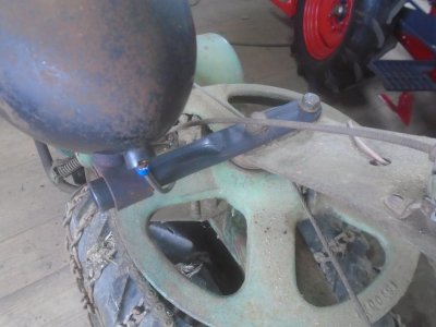

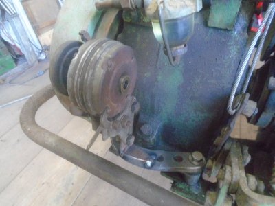

On the original Bendix light kits, the mounting bracket for the generator was bolted to the outside of the flywheel shroud.
I don't want to drill holes in the side of the shroud so I'm going to make a bracket that is held in place with the two engine mounting bolts.

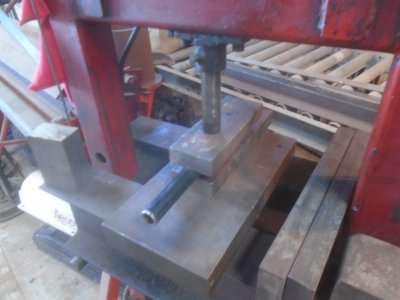

First I formed a bracket the curves out around the oil fill.
Then I made an angle bracket that the generator bolts to and this is tack welded to the first bracket.
This is the finished generator mounting bracket. I sprayed a little green paint on it and then wiped it with a rag before the paint dried. This left a little color and some of the bare metal edges showing. The bare edges will form rust on them fairly quickly and it will blend in more with the patina of the rest of the tractor.
