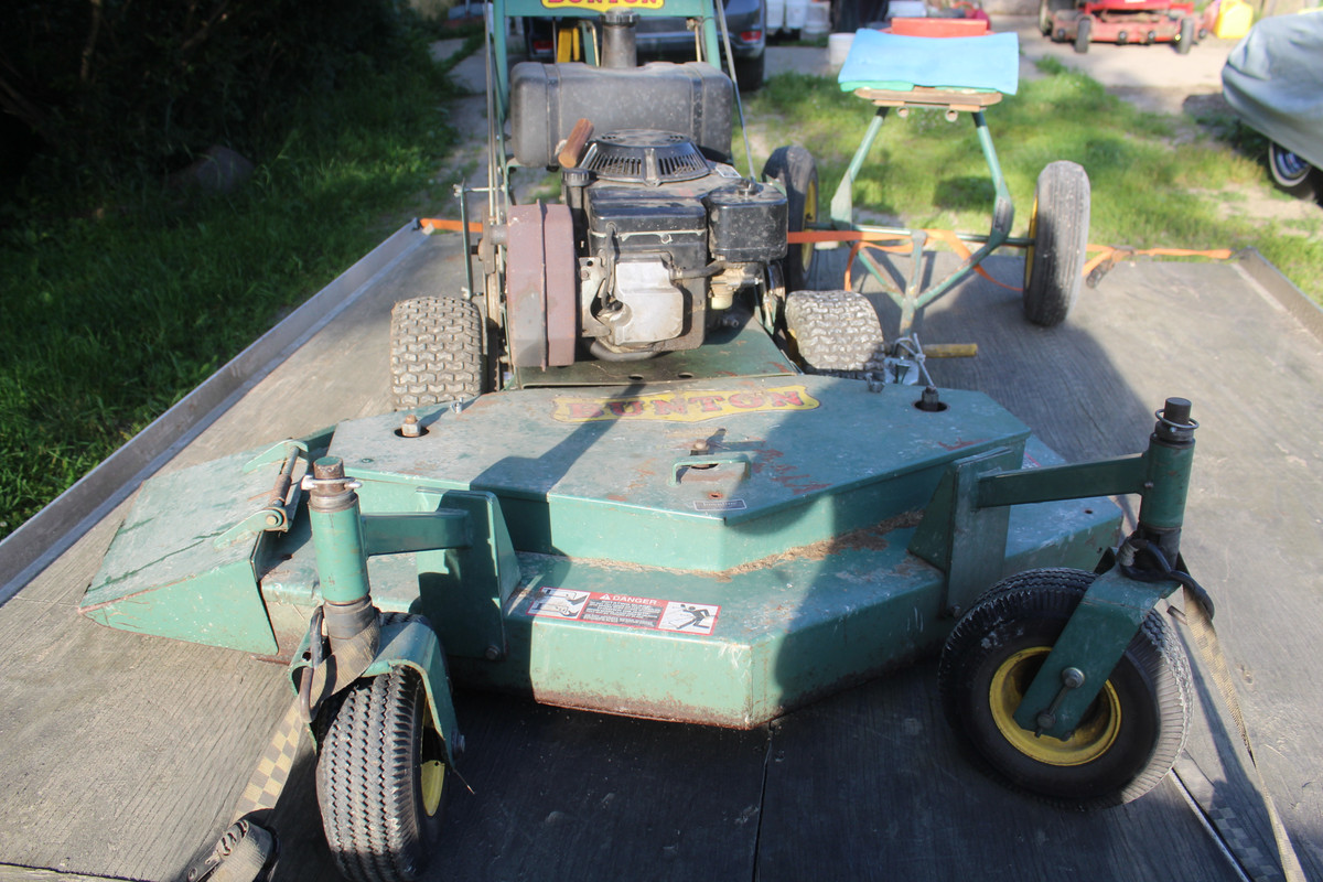

Bunton comercial walk behind mower given to me as a no start last summer.
Deck is 48 inches and the engine is a kohler 14 hp manual start.

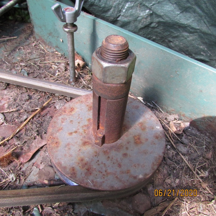

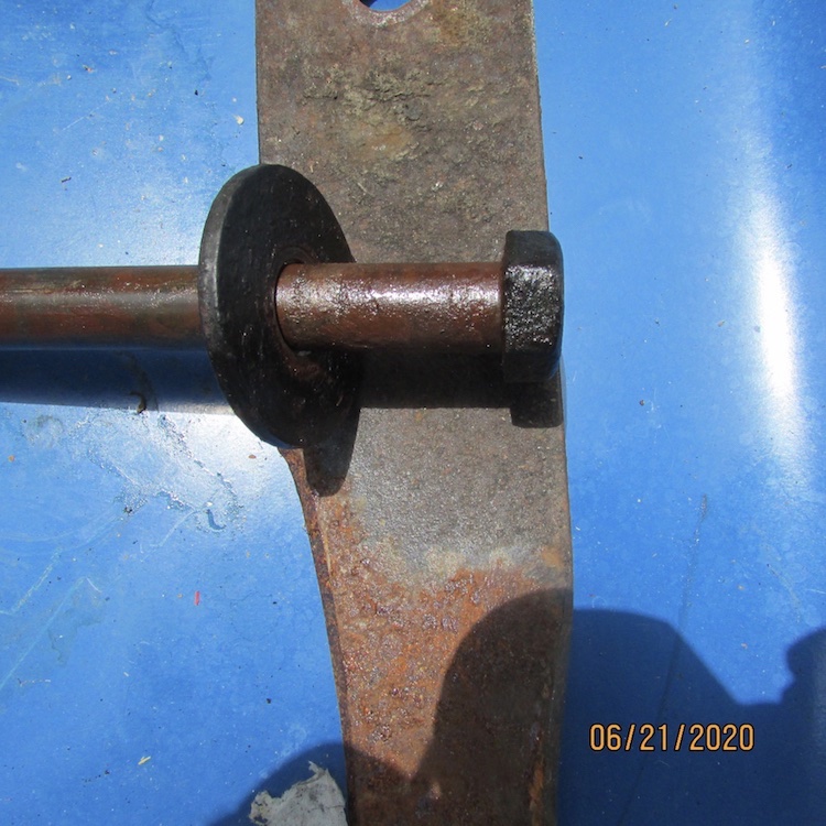

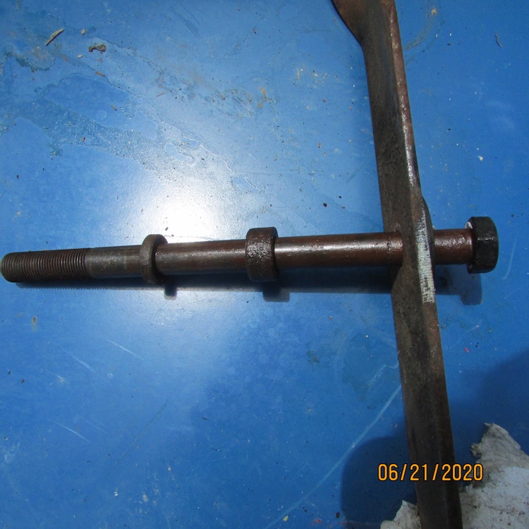

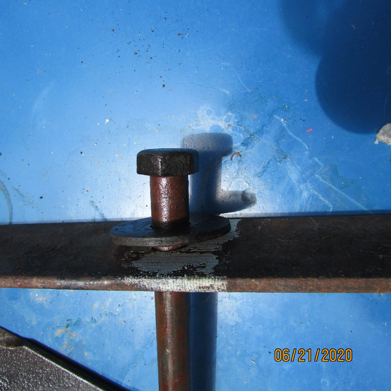

He grabs a big pipe wrench and says to put it right next to the blade on that raised part and hold on. he hit it with the impact again and there was a autable pop that raised part next to the blade fall in my hand. take the thing out of the vice and decided to heat it up but the blade fell down and you then could see the whole unit was a thru bolt with bushings on one side and the bolt head and washer on the other side.

Ya because the shaft is the bolt. Couldn't see it till the bushing broke. I don't really under stand whey the bushing broke either instead of looseing up and slide enough to see it was not a bolt in the shaft.
