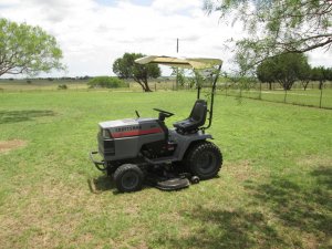

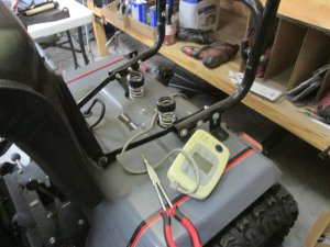

Dang, I didn't have a thread for him here either. I tried to waken him from his summer slumber as I need BOH to tow the rock sifter trailer to clean the dirt for the trenching Hulk II did.

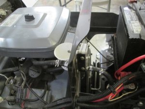

I have a no fuel issue, so I checked the gas, 3/4 tank. I removed the fuel line from the carb side of the fuel pump and pressurized the tank. No fuel. I then disconnected the line going into the pump and got some flow and trash. I connected the line back up, and still no flow through the pump. I am on hold right now till I go to town and get some carb cleaner to blow the pump out.

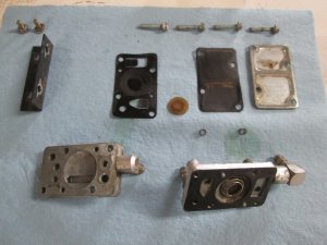

Cleaned the fuel pump out and was able to get fuel to flow through it. Won't be able to see if it works till later this evening when I get off work and can open the shop doors.
I think BOH is due a fuel line and filter replacement as I think the inside of the fuel line is deteriorating.
