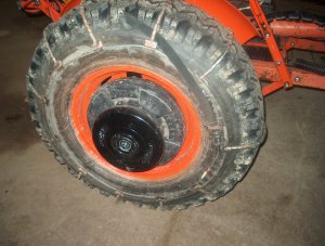

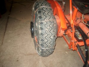

I want a set of chains for the Country Squire it has 16" rear wheels and I don't have an extra set of regular chains, and my brother had a set of cable chains they are for either 20 or 22" tires so I cut about 30" out and spliced them back together and installed them to see how they looked and the fit is good.
Has anyone used these if so whats your experience? I think they good be good on asphalt and concrete driveways if scaring and tearing it up is a concern

Bet they will ride a lot better than chains..though it looks like they could use another cross cable between each one..?

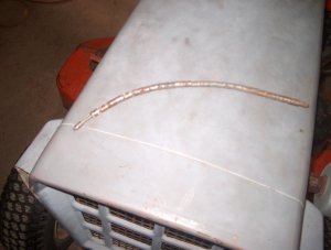

I 'm thinking the same and have taken one off the piece I cut out, man is that a job used my Oxy torch heated it cherry red and a large nippers to grip it, have a half dozen so will work on getting more but right now got to get things ready for fall . winter

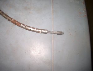

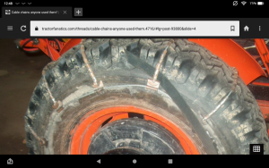

What's wrapped around the cables ???
Best close up shot I could get.
Or what does the cable go thru as it goes over the tire.? Looks like little pieces of something ?

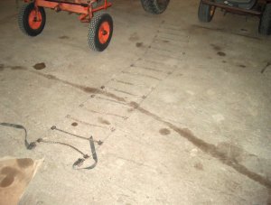

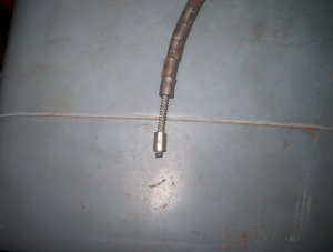

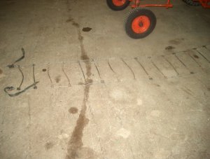

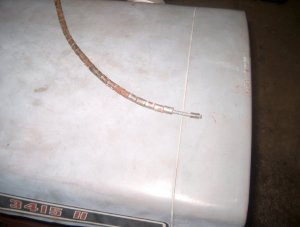

After picking the pumpkins mowing off the rest of the garden in hopes it will dry some I can plow tomorrow or Tuesday, then mowed the area behind the house and around the garden for the last time this year, I went in to the shop and checked on it and remembered to take some pictures of the cross bar link of the cable chains. I can't really determine what the center is it doesn't look to be cable the rollers can be seen just simple hard steel rollers.

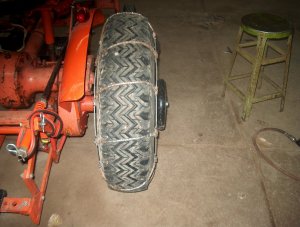

This afternoon I was moving decks to the back storage area for winter and had to pull Husqvarna #3 around to the shop (the darn drive belt popped off) so got to work on that anyway I used the CS with the cable chains installed and was surprised at how noticeable they were on hard surfaces but didn't feel a thing on the ground, I'm thinking they will work good in the snow, I'm also hoping I can't confirm this until late Feb ;)
