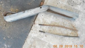

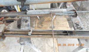

Our 1987 Avion travel trailer has similar stabilizers. Ours are made by BAL. They are very handy.
Some people confuse “stabilizer” with “jack”. If that bend is pretty straight with the rest of the body, that’s a good indication of someone trying to “jack” with it. If it looks like it was peeled backwards or forwards, someone drove off with them lowered.
I like this design MUCH better than a scissor-type stabilizer on a travel trailer. I have always thought the scissor-type looked dorky when they are stowed for travel.
These are the BAL brand! I have no idea why/how they got bent up.
