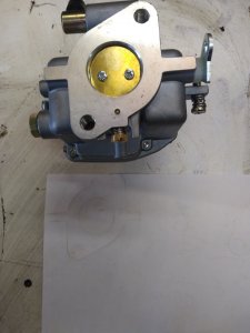

New Carb

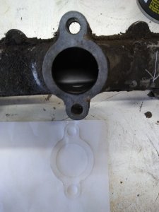

Intake

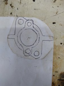

Paper template
1/4" copper plate

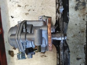

Assembled
(While it was off, I split the intake and resealed it. Dumba$$ idea to make them that way, but whatever.

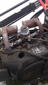

And done.
The air cleaner will be modified to work or a different one put on and then the friggin thing may work when I try it next time. Grrr.

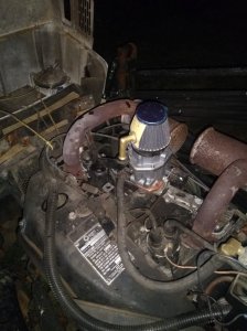

I bought a “filter” that would fit al the measurements for under the hood.
It was actually just a pre cleaner, in spite of the ads assurance it was a filter.
Anyways... I put a piece of filter foam in, a piece of SS hardware cloth on top of the carb so the engine doesn’t suck in my foam a second time, and put the breather back to the carb.
