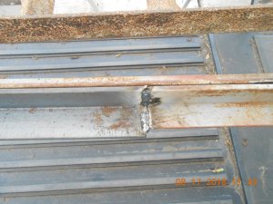

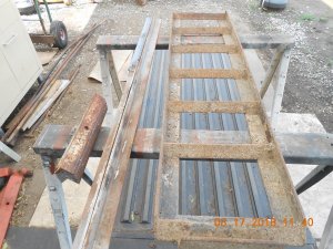

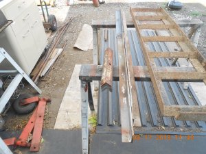

A friend found a trailer ramp hitchhiking. Took him some time, but he gave it to me. I spent most of yesterday scavenging up some material to make it's mate. Couldn't find any 2X2X1/4, but did find some 2x1-1/2X1/4. cut all the cross angles and got ready for welding. Used the Lincoln and 3/32" 6013 rod. Went together rather well.

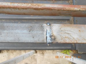

I didn't have a long enough piece for the one side so I welded in a chunk of 2X2 to make up for that.

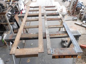

Trimmed the corners of the cross pieces.
And the finished product!
