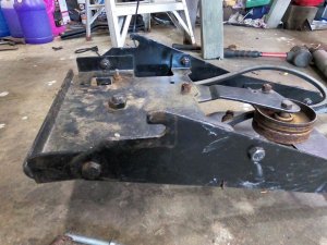

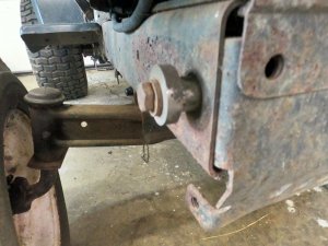

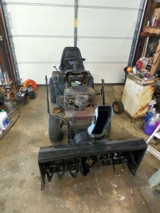

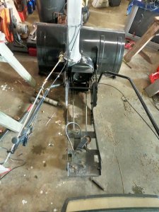

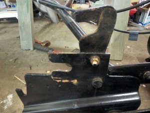

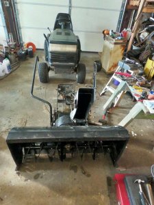

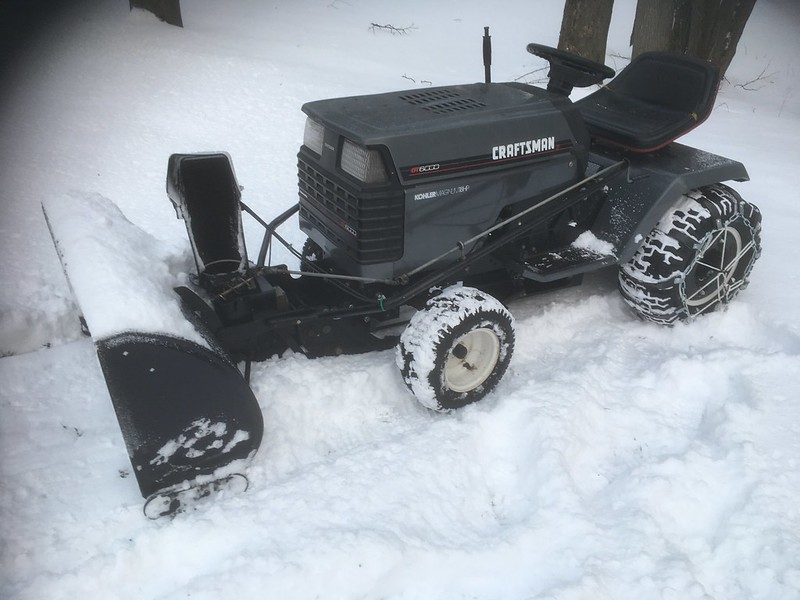

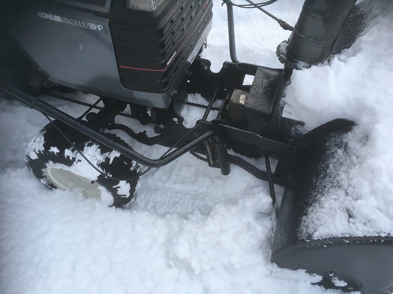

When I got my Craftsman, it came with an MTD snow blower. Once I got the GT where I wanted it to be, I started to look at how I wanted to mount the snow blower for testing this winter. I ordered some parts from Sears and was able to mount the blower. The PTO hardware was mounted underneath as best I could. A couple of rope measurements and a few lucky guesses and the belts were installed.

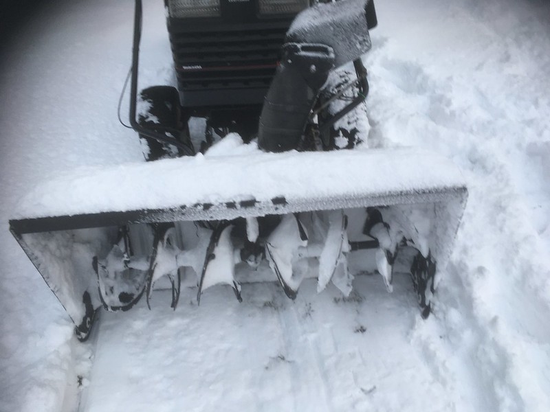

It worked fine. Fast forward to yesterdays 4 - 6 inches of snow and an adjustment to a belt tensioner and I was getting the correct performance to blow snow. The terra tracs were mixed results on the steep driveway. The blower did what it should and will be a decent back up for the next place. I finished the driveway with the Ariens walk behind as usual.
