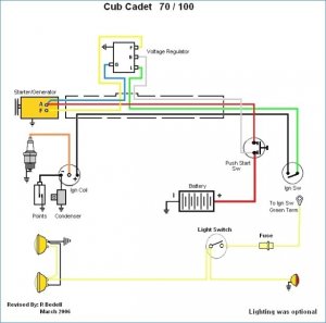

Cub cadet org wiring diagram
Ky wil
Well-Known Member
Dose anyone know where I can get a wiring diagram for an cub cadet original? I'm having trouble with it charging.
I just had another thought. I'm just assuming/ hoping my genarator good bc it starting ok. Is there anyway I can check it? I'm almost sure the voltage regular is bad.
Check the generator output between the field terminal (+ meter) to ground (- meter) at full throttle. If that is good, do the same between the B or BAT on the regulator and ground.
