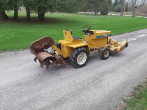

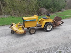

FINALLY got the tiller mounted and working on my E15
It's a Wheel Horse tiller, GE design and works good, lots of power at the times.
Gonna do the garden when the rain stops.
Tiller motor is rated at 2+1/2 hp, same as the snow blower motor but the tiller motor doesn't seem to work as hard, draws less amps under load.
I was surprised at how much power it has and how easily to chips up the ground.
