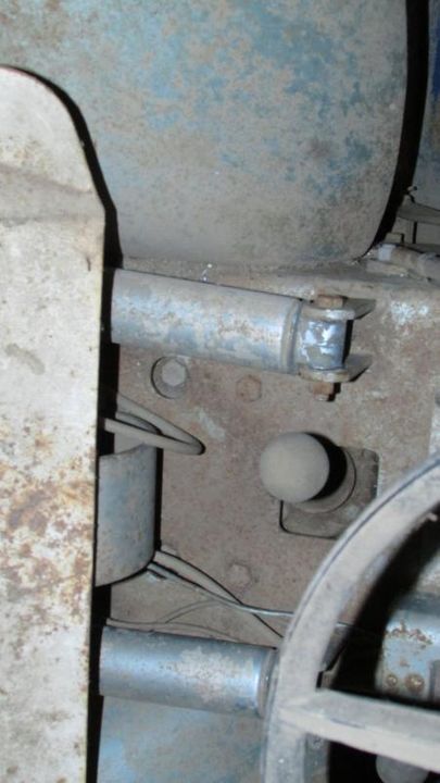

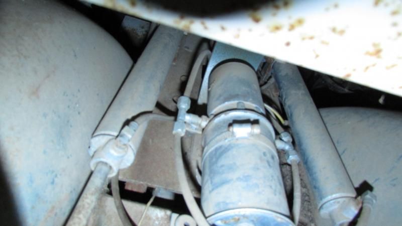

I have a older sears SS12 with hrydrlic 3 point hitch on it.
Old GM convertable top hrydrlic pump, the pair of Convertible cylinders , and a heavy duty switch to operate it.
Those old GM pumps had the motor and oil resivor all in one.
I have pictures on Photo Bucket and ya'll know what a mess that is. Haven't been able to get on the site for months.
I should probably take some new pictures of the set up. when I have time.
