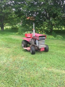

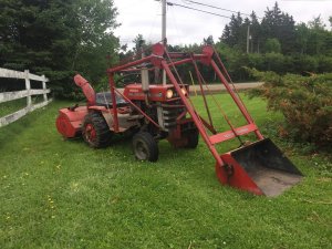

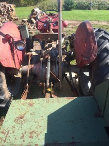

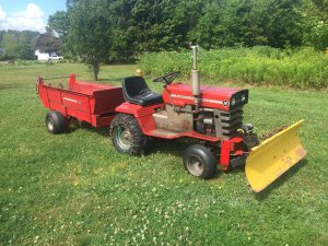

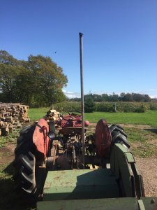

Black iron stuff is what I use. And brace where you can. I didn’t use any sealant. Mine have been on for years. I like the look. All my Massey Ferguson’s have stacks. MF 7, 12, 14.

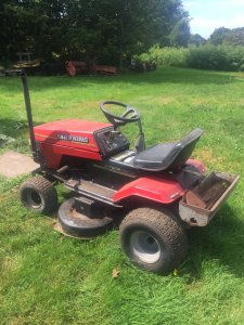

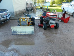

I can't do a stack here because of trees with fairly low branches. I had to build both the exhaust setups on my MF GT's and both come out the right front and discharge down. Don't ever seem to get fumes with these non original engines set up that way. Should be able to see them in this most recent pic.
