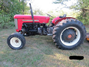

Back story: So I am refurbishing a '59 Massey 65. I went an looked at the tractor, it started great and ran like a top. Checked the oil and it was milky. No oil in the coolant, no steam from the exhaust. I figured it was a head gasket. Pulled the head off and it looked fine. The gasket was in pretty rough shape. I went ahead and picked up a whole top end gasket set. During reassembly I noticed that the exhaust manifold studs (which go through to the water jacket) were in bad shape. I pulled them out and sure enough one of them had been drilled & tapped from a 5/16 fine to a 3/8 fine. Evidently the tap that the PO used was junk because the threads seemed way to loose. Sure enough I fired it up and it immediately started leak coolant. I tried locktite, still leaked. Pipe thread sealant rated for steam, still leaked.
