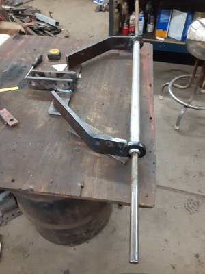

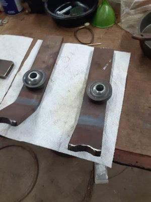

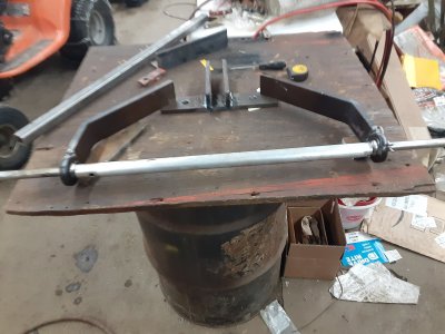

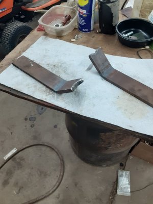

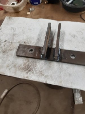

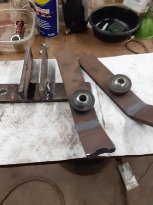

The factory sold an adapter that bolted to the lift draw bar on the Power Kings that allowed you to hitch up 3 pt attachments it wasn't the handiest thing but it did work. I thought I'd build one just for the fun of it, got the material cut holes drilled that lift arms bent and the ball joint welded on just have to weld the lift arms to the adapter plate.
