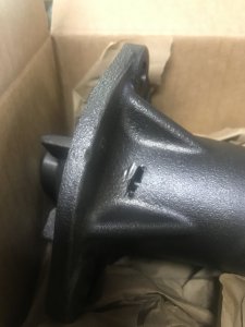

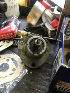

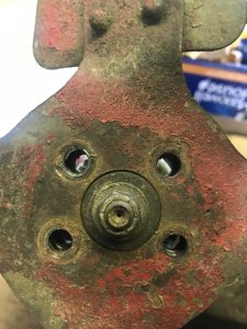

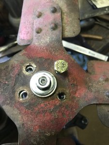

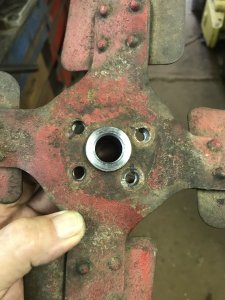

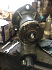

Well well well. You would think that if you bought a new part, ya could go home with it and just put it on, but noooo, had to modify the cotter pin holding the pulley/fan mount, so the pulley would fit on. I had went back to the dealer to see what they wanted me to do or them to do, before I touched it, and have no warranty. So got that fixed. Went back home. So then I tried the pulley and fan on new pump with new bolts to make sure that all fit. Didn’t fit. Could get one bolt in, second was hard to put in, next two wouldn’t go in. Centre to centre hole spacing was off. Jumpins. Back to the dealer I go. I didn’t really want to drill or wallo out the holes in the fan blade. So they suggested that or would get another pump. It was my call. Figuring new pump would be the same, I said I’ll do some thing with it. So I ended up taking the old fan/pulley mounting coupling off the old pump and putting it on the new pump. So there’s a days Beepin around to get the part useable.
So pump is on motor now, will see how much farther I get before something else goes haywire.
Quite the professional way to put the drain hole in the bottom from the factory. !

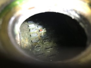

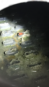

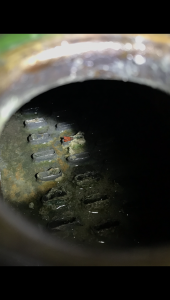

And there’s the reason why you don’t use silicone for gaskets on a engine. Someone before me had this apart. There was no gasket on the thermostat housing. All orange silicone.

When I pulled the engine out of June Bug there was that red or orange silicone squeezed out around the water pump. Wonder how much is in the radiator and heater core. I think some people are under the impression that they have to use the whole tube for each gasket. :mad:
