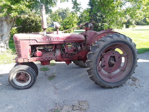

Been wanting an H. One came up near me for a good price. It needs some love: That right tire needs to be turned around, brakes need adjusting, needs a new battery and the muffler has seen better days.
I'm going to lend it to a community educational farm where I volunteer. The farm has two tractors and often it should have three. This one will pull wagon rides and may get hooked to the hay baler from time to time.

Those are real easy to change over to 12V too. Starter will handle the 12V with no problem. Small car alternator will fit under the hood where the generator is. Get one with thew built in regulator. MoPar dropping resistor takes care of the points, coil etc. Change a couple 3 bulbs and your in business. Should be able to change the right rim & tire around without removing the center, especially with the one piece center weight.
If the charging system isn't working I may go that route. After the seller boosted it we drove it about 2 miles to the home of my boss at the farm. Another of the volunteers has an equipment trailer and will transport it to the farm when we get a good battery in. I'll probably use the battery from my Cub until I can check the charging system. The ammeter seemed to read charging, but only a couple amps.
I saw that. The tire on the left has the valve facing in while the one on the right faces out. I'll probably switch them side to side so both valves face out. It's a low priority for the use it'll be getting.
