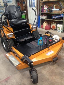

Any one have long term foame dtires on lawn equipment?
Front pivot tires on my mower keep going flat. Spent nearly a whole day getting trhe axel out of just one yesterday so I could install a tube.
why not foam them? wonder about the long term usage?
Al
Foam makes them very stiff and bouncy, I've ran forklifts with foam filled tires and it's like riding on solid rubber tires.
Lot of the front mounts like that are solid/ foam filled. I know JD, Grasshopper and even my Woods are..
The drives on the Bunton don't get much traction. spit in front of one and it will start spinning.
