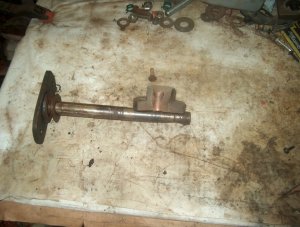

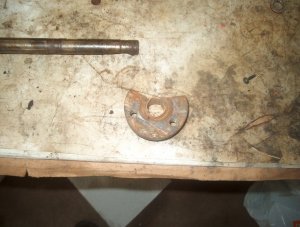

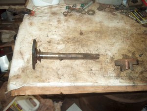

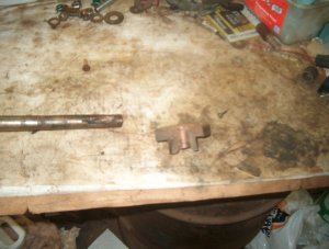

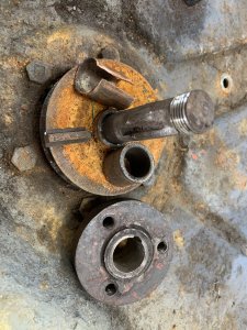

Removed the deck and disassembled the center drive spindle and I'm pretty sure I've found what was causing all the problems with the drive belt. The drive pulley had a wobble of about 3/8" so removed the pully and found the cast iron hub was broken about a 1/3 of it was missing and the spindle shaft keyway is badly wallowed out and someone had installed a brass bushing to tighten things up, just guessing I'm thinking that forcing the bub/bushing on may have cracked and broke the hub, so now its to try and find a spindle assembly

Our decks are the same but my deck from the 7117 is different. I thought I could replace my bad center spindle from it but can’t. The spindles on the 7117 have splines on the blade end. These must be a weak point on these.
