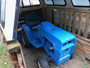

The tank on my 1655 White had severe damage. I used a 2.5 gal common red plastic fuel container. Drilled the hole in the side near the bottom for the grommet, strapped it in and has worked for a couple years that way. Long ways from OEM but it feeds the L head Briggs OK. About $5 and had a fuel tank up and running.
