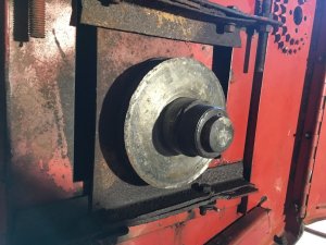

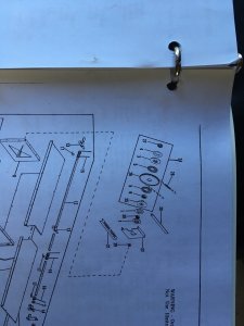

Can anyone tell me how the reel clutch assembly comes off of the shaft. I tried heat,beat,and a puller and cannot get it to budge. There is a bearing in behind it that needs replaced. It is keyed on the shaft with a woodruff key. Cannot find a service manual for this old Gehl 880. See pics. Its item25 on attached. I also drilled out the key, hoping that would relieve some of the pressure
Anybody had experience with this or something similar.

I was thing of heating shaft red hot and trying to pull it again.
Looking at the parts diagram, the back plate and the keyed portion are separate and possibly need to be removed individually. No idea really, but a thought. Not sure how you'd do that though as there's nothing to pull the keyed part.

Back in the late 80's early 90's working on combine harvester's in similar situations of trying to get a hub off to replace a bearing behind the hub. We would heat up the hub red hot, not the shaft, with a rosebud tip and then spray it with cold water from a garden hose. I remember a couple of times we had to do that 2-3 times before the hub would move. The first couple of times we were concerned the hub may crack or break but we never had one crack.
Have you tried hitting the hub to move it in a little before trying to take it off to unlock the rust weld?
I tried heating red hot yesterday and cooling several times. This thing wont move. The hub is only 1 piece. I left it hot and under the puller pressure last night, will see what happens this morning. Starting to think maybe this key is something special. If I could find a new or used hub I would cut the old one off. Called around the country and cannot find a hub for this Gehl
