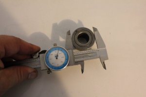

The bushings seem to work well for grass cutting, but if you plan on putting your front end under a load with various accessories that attach to the front, ball bearings are a good upgrade, the JD part #AM127304 as an example will work fine on the Husqvarna, AYP, Craftsman, MTD, JD, brands that come with bushings on the 8”X5” (more specific 8”X5.38” with 1-3/8” ID wheel bore).

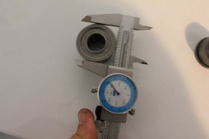

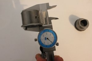

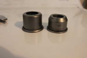

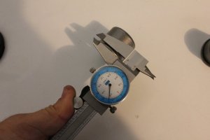

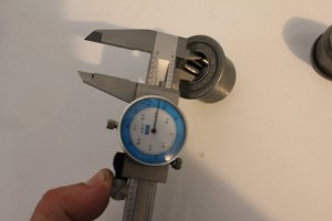

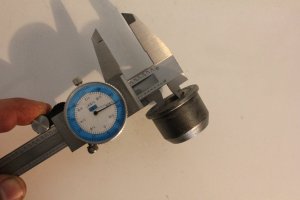

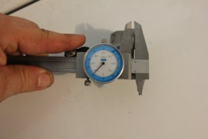

I decided to try roller bearings that are nearly 1” wide, doubling the bearing support. The ball bearing upgrade requires zero fabrication effort, simple and straight forward. This does require minor attention that a dremel and a cut off wheel can easily fix.

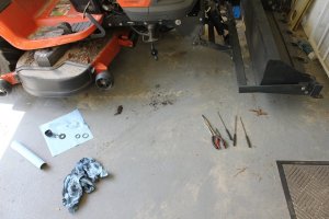

I will put in as many posts for picture accommodation. This is something that my Dealer recommends to his commercial customers on their zero turns, but is the first on a GT for him and of course me.
I’m happy with how it turned out, as for longevity, we’ll see. I also want to point out that the bushings are not worn out yet, some wear, I just wanted to upgrade with the front maintenance, replace bushings, washers, clean, fresh grease, etc. It’s been nearly 100 hrs since this was last done fully, and all that time was using a JBJR.

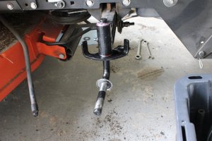

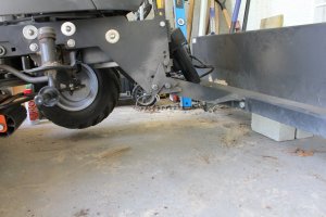

Another use for a JBJR, front end lift!

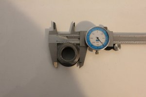

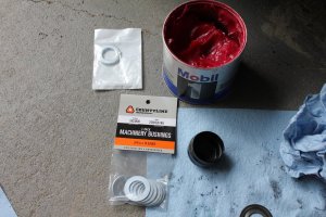

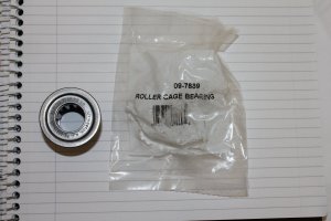

The bearings are from Berliss Bearing Co, Livingston NJ.
# on the bearing FB-94816 NA
The package says Roller Cage Bearing #09-7869

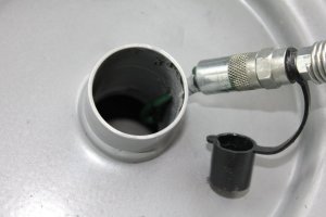

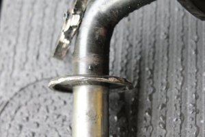

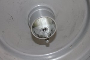

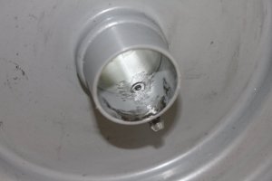

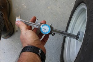

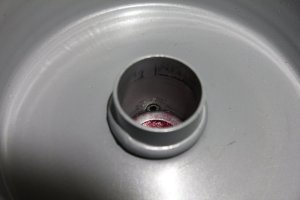

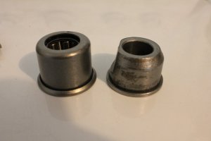

The modification for fit was to the zerk fitting, on the inside of the hub, it needed to be carefully ground down flush with the inside wall of the wheel hub. This roller bearing is an 1/8” - longer than the stock bushings

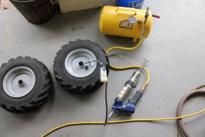

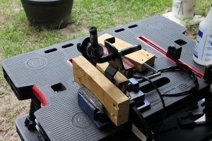

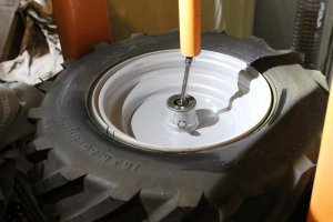

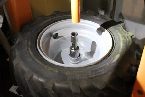

I also used a Harbor Freight 12-ton shop press with an air powered press modification. The press is not necessary but is easier and has less risk involved.
I also pre-grease-packed the rollers and placed them in a zip lock bag, and put them in the freezer. I don’t think placing them in the freezer is necessary either being that the parts for these little GT's are not that precise, but again it made the process very easy (little to no stress) on the parts.

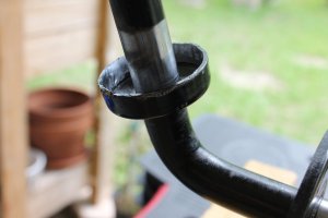

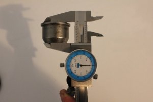

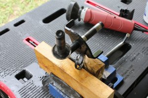

Because the roller bearing shoulder support is wider than on the stock bushings, I had to cut off most of the metal dust cup on the spindle. The part that covers the inside wheel hub when mounted. I left an 1/8” to keep the strength of the piece. The wheel is still properly spaced and supported with the washers but is free to rotate.

the zerk fitting end
and make sure to push grease through the zerk after it's shaved as a precaution so as to not get metal in your bearings.

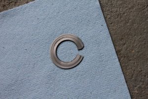

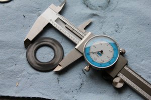

The thrust washers that came with the GT are weak and the machine bushings from TS seem to hold up better.
The zerk fitting and new roller bearing have just enough clearance.
