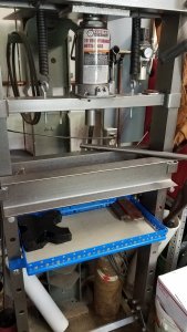

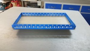

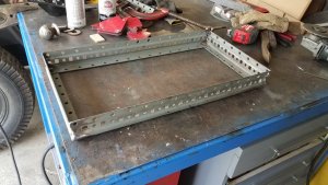

This will be a series of things mostly already on YouTube to make this press better. First up is a small work table. I have an abundance of these metal shelf frames. I cut a few pieces & welded the frame. I already had some painted on one side 1/2" OSB for the bottom. The shelf measures 11 1/2" x 22". Its being held up by 1/2" carriage bolts right now. I have a project coming up using 3/4" round stock so I'll wait to see what scrap I have to make two pins.
