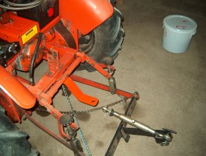

Was there a factory trailer hitch for the power kings? Mine has the three point that I hook a trailer to. It will drift though. Would like to have draw bar stationary hitch.

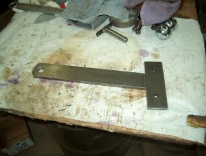

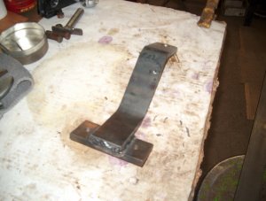

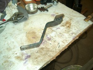

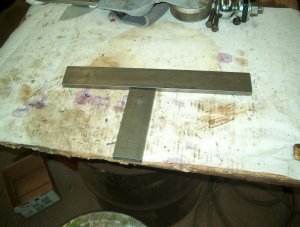

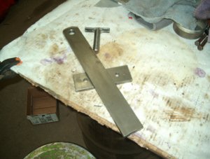

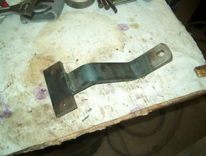

Yes there is I've seen them listed on e bay, I fabricated a couple for my tractors I find them very handy, copied the factory ones
Could you give me the dimensions? Please.
Hi the draw bar is 2" X 1/2" X 15" the mount is 2"X 1/2" X 6" mounting bolts 7/16" X 3.5" GR5 the draw bar hole is 3/4" I'll have to check the drop its 4" but that will depend on what rear wheel the tractor has 16" or 24" the general rule of thumb is the draw bar should be 10" up from the ground mine is 11" above ground level
Good job. :thumbs: I'd heat treat the complete drawbar. Or not,,,1/2" is pretty stout
