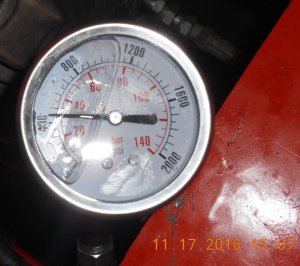

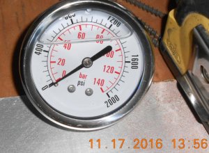

I finally got a gauge to test the pressure on Alice. It's a 2000 lb. liquid filled gauge.
Here I have it plumbed in and Alice at full throttle.

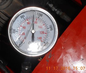

Here I am working the lift valve.

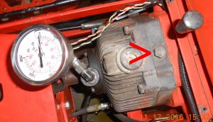

I also took this plug out and checked for blockage in there. Looks clear.
Don't know what this means.
Where does the oil come back into the system from the valve?
Into the side of the Eaton pump. Already checked that fitting.

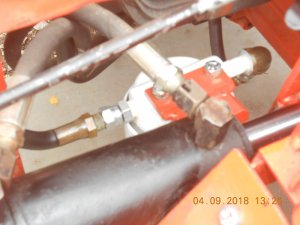

Well a small one. The lift cylinder has decided it wants to leak some! But not as bad as that filter base did!
