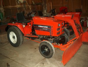

Installed a snow plow blade on the 1620 Power king
MNGB

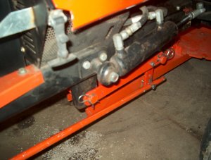

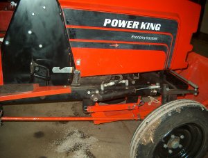

Hi all, well spent a couple of days installing a snow plow blade from my 1973 PK on the 1989 1620, it went well once I got the dozer blade manual out and read it over. The only thing I had to do was drill a couple of 3/8" holes in the tie links, this is because the Plastic King front hitch mounts were changed slightly that being the forward one the 1" slot was changed from vertical to horizontal this required the locking latch to be rotated 90 degrees and this put the holding pin/bolt to be inline with the tie link thus the need to drill the link so the lock pin pass thur link the hitch mount and the latch. The blade now raises and lowers as it should I really wish my tractor had dual hydraulics so the blade could have hydro angling.

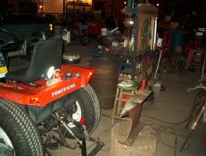

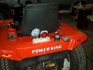

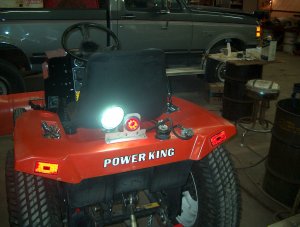

I hope to use the 1620 for plowing snow this winter so one of the things I wanted was a tail light and a back work light and LED lights are my preference so I fabricated a mount for a LED tail light and that turned out good didn't have a LED light so a Halogen light was used. But I found a pair of LED lights on Amazon, they are 27 watt 4.5" dia and the cost was good $13.50 for the pair, so today they came and I installed one of the LED light assys and I like it it will be great for rear visibility. The 2nd picture is with the shop lights on and the 3rd is with them off

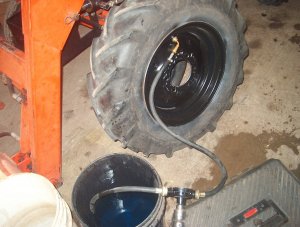

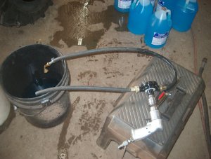

Hi all, got 10.5 gallons in each tire that went good, Hi 4getgto yes I pumped it in I have a small pump that you chuck up in a 1/4" drill and a bought an adapter on e bay to connect a garden hose from the pump to the tire adapter I than poured 5 gallons into a 5 gal bucket have the rear wheel jacked up off the ground let all the air out and with the valve core remove and valve stem at the top start pumping. Got 5 gallons in then let the air out it just comes back thur the hose and pump by the time I get another 5 gallon into the bucket the air is done and start pumping again when that was in poured another gallon in the bucket and pumped that in but by then the fluid was above the valve stem so about a 1/2 gallon came back out into the bucket then put the valve core in and aired up the tires to 10 PSI Picture of my 1984 but the process is the same
