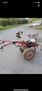

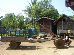

Sorry no idea how etended up with 2 images. Thats as i bought my 2 wheeler with the extras. Ive since made a trailer for her and currently modifying a circular saw to run of the power takeoff hub. She who must be obeyed wont let me commission that until covid is finishedincase i cut my arm off.

Looks looks the kind of rugged beast you couldn't hurt unless you let it fall off the trailer on the free way.

Those things are a beast. Back in the early 70's when I was in Japan a lot of farming was done with machines like that. Would also pull ride-on trailers with them.
