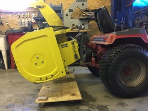

I've always struggled to carry my snowblower to/from my shed as the entry door is somewhere around 52" wide and I have to make a close radius turn as the shed is near a hedge. Going with the front of the tractor in the shed is really not great therefore I build a cheap adapter to be able to carry the snowblower with the 3pts hitch. Just a bunch of stuff I had laying around. The adapter is installed/removed by removing one of the nuts

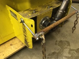

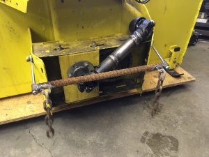

To carry the snowblower I simply attach the 2 chains in the slots made for this kind of purposes in my "default" accessory.
It does the job perfectly, 0$ not a lot of times and it works!

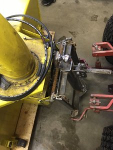

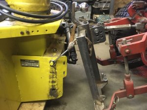

A possible improvement or other part I'll probably make one day would be a spacer to avoid the PTO shaft from contacting the vertical receiver in my 3pts adapter and also keep the snowblower a bit more vertical, it would help backing the snowblower.
