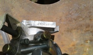

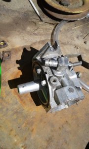

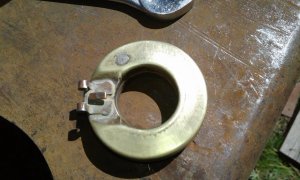

Well it was running good so I started setting up to mount a small back blade on it. Started out back to get the blade and it just quit. Checked the spark and that looks fine so back to pulling the carb. Evidently I didn't get the fuel tank and lines clean, there is now rust and crud in the carb. So I take the carb apart and clean it out again and find that the float is now full of gas. So I heat the float to get it to expel the gas and once it is dried out paint it with fingernail polish to seal it. Put it all back together and now it runs fine again.
This is the carb I have.

The float.

I am obviously going to need a new float this one has considerable pitting from the carb sitting for a long time with water in it. Experience tells me that the fingernail polish will stand up for about a year and the deteriorated portion is to large to solder. It is a shame they have downgradedthe quality of the fingernail polish, it used to last forever.
