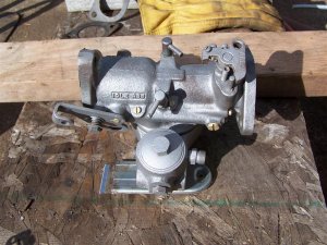

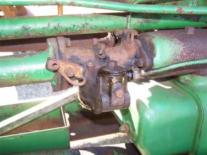

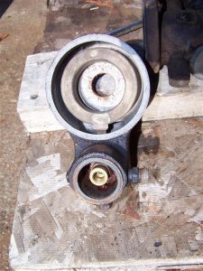

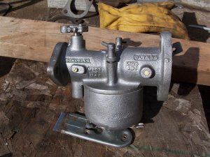

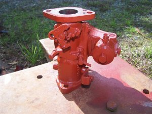

Our 1945 John Deere B hand start was getting tough to start. A couple of days ago I got dad to jump on the B while I towed with another tractor. Had to pull it quite a bit to get it going. Once running it acted like a stuck float valve or sunken float. I pulled the carb off today and found the float full of fuel. Since its apart I thought I should clean it up and paint it. I'll see if the float can be repaired or if I need to order one.

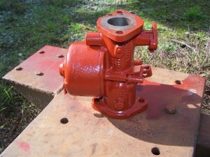

Got sidetracked on some other priorities for a few days. Just got in from shooting some JD green on the carb.

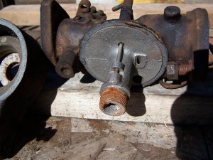

I checked out the float in some hot water and got a lot of bubbles. After some steel wool you can see the crack. I have opened up 3 more carbs and found all of the floats have some leaks. Two of them are in better shape and are easier fixes so I will use one of them. I should probably order a couple new floats and gasket sets and go thru all of the carbs this winter. They make nice indoor jobs during the nasty weather.
