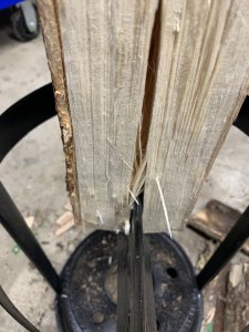

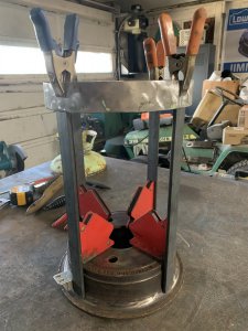

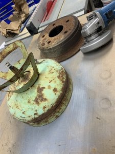

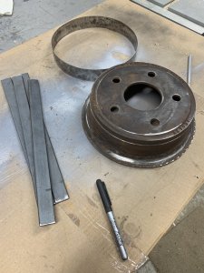

I thought I would wing one of these. I cut a lot of kindling using my wood scraps from projects. I watched a few of these on YouTube and gathered a few ideas.
I’m using some things I already have. The top ring I cut from a section of an old refrigerant tank. The four posts are some 1/4” flat stock and of coarse the bottom from an old brake rotor.

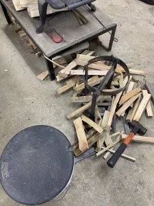

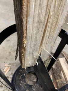

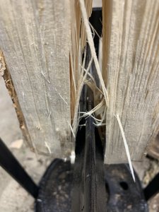

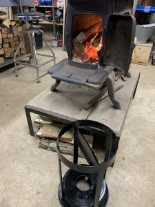

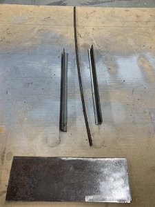

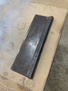

The blade is also a piece of 1/4” flat stock. I trimmed one side of some 3/4” angle iron so it creates a wedge at the bottom of the blade. I’m hoping to get the blade welded up tomorrow and attached to the frame.
A94D904A-E36D-4154-BC01-9ED810FC164B.jpegAD03F327-ADDA-429C-8407-22A564C01FDF.jpeg42E8C588-1AB1-4B9D-B2D0-1E6253471667.jpeg

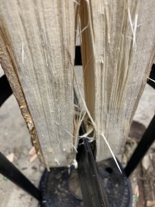

Those sure are handy. I bought a Kindling Cracker brand from Northern Tool for my dad 3 years ago and been thinking of making a secod one that will take bigger pieces. The thing works great. One thing I might suggest if you haven't welded the pieces of angle on for the wedge yet would be to make them so it's a bit wider. The one I have the wedge is probable 4-5 inches wide at the bottom. Only takes a couple hits with the hammer end of the maul and the piece of wood is split in 2
