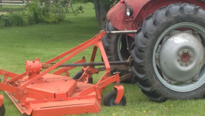

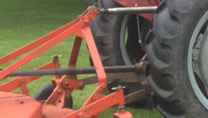

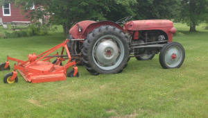

Ahh. I had a look at a picture of the 3 point. I see how it works. Neat idea. I'm wondering if the up/down lever for the 3 point has sort of a neutral position that the 3 point would move some. The 6' rear finish mower I have has the float built into the mower, for movement over the grass. each point has some float. The mower is hooked to a 51 Ferguson tractor.
