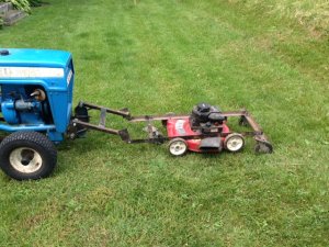

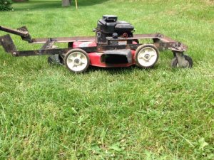

poncho62
Hangin' with the cool kids
#7
Something to consider is the amount of time the mower is going to be at a steep angle. With the splash system they have, the oil might dry up to where it needs it. Pushing my mower up the hill, it is only at an angle for a few seconds then down on the flat again. Going along a ditch may keep your mower at an angle for quite a while.....Just sayin'
chieffan
#8
Your 100% correct and I have thought about that. Would have to have a limiter built in. Not figuring a mowing anything lawn short. More of taking the top off and leaving 6-8" or so. Be a lot of back and forth using your method, so got to thinking about a side hanging unit. My not even be feasible, will see.
