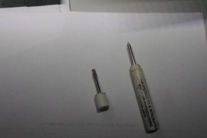

Between tracking Santa on NORAD and reading I decided I needed to make this mini screwdriver. I need to adjust the pilot needle on a MIKUNI carb in a Polaris Ranger I been working on. There is about 2" of free space between the bottom of the carb and that access port for this adjusting needle. Have several of the small pocket screwdriver around so cut the end off on for the "handle" about 1/2" long. Cut the blade end off the shaft about 1 - 1/2" long. JBWeld the blade end into the hole of the handle and let it set up. The remainder of the shaft I pointed for a mini point, just in case I need a small one some time. Next time I get the Ranger out and warmed up good I might be able to adjust that pilot needle so it smooths out a lot better and will idle. Don't do either one good right now.
