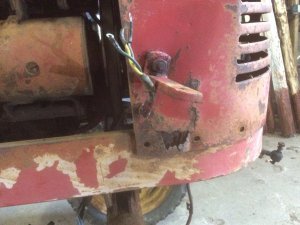

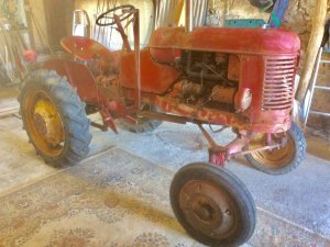

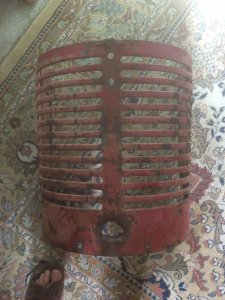

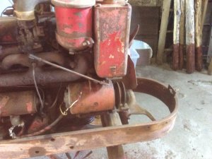

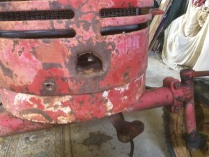

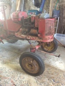

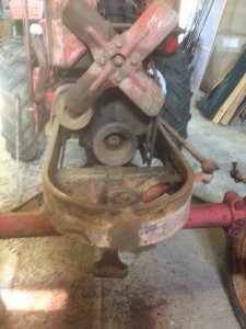

Hi everyone. So after three days of searching the Internet sending emails for information on my Pony’s year of manufacture I have started the long clean up operation. Working on the process of elimination I have narrowed the year of manufacture down to the years between 1954 and 57. !! So with the absence of a workshop manual ( I have yet to find one coming with a sensible price) I have removed the front grill and radiator. The grill has some rust in the lower corner so I have to attend to that and the grill has had a bang in the front and needs attention. I have already sorted two minor dents in the bonnet. It’s amazing how your skills learnt some 52 years ago come back to you. Thankfully this tractor seems to be fairly easy to work on which is making my life a bit easier although some of the nuts and bolts have been bloody difficult to undoe. I have added some pictures of my progress. Hopefully not too boring for those of you who have already been a great help.

You going to paint it our just take the dings out?
:D Al
Morning Alley.I am taking the Pony back to the base metal on the parts I can get to and repaint the complete tractor. I am considering replacing the front timing cover/crankcase oil seal along with the sump gasket whilst I have the radiator out but am holding back from stripping the engine down as it appears to run quite smoothly considering it’s age,

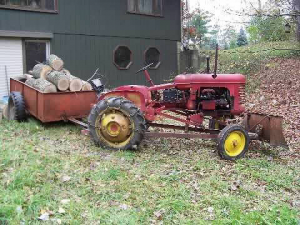

I have a 1949 Pony and a 1954 Pacer. Same as the pony except a tiny bit difference in thre front end set up and instead of having the 11HP 62 cubic inch engine it has the 16 HP N92 Cubic inch engine.
The pony also has a manual lift and the pacers is hydrlic. Both use the same tool bars and equipment installed on them.
Pacer
