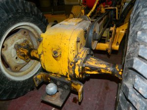

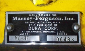

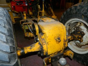

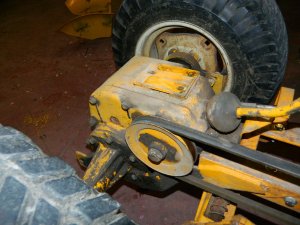

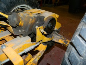

Hi Fanatics, I'm thinking a gasket/seal kit is in order for the MF8E if such a thing exists. I had mistakenly thought it was a Peerless but with Lance Skene's help determined it was not. I could do some searches in more detail with an I.D. on this transaxle.
Thanks for any help or advice.
Here's pics.

Have no idea. Sure is not the same as a MF 7. But similar in build. Yours looks to be much more rugged.
Paper gaskets you could make. Other seals could be measured and got at a local farm or big truck centre.
Just some ideas.

As far as I know they are unique to Porter-Cable or Dura garden tractors. MF Executives and Moto-mower GTs. They don't come up for sale very often. It may take a while, but they do show up from time to time.
I had to make my own set of axle seals 2 years ago... simpler that way, less down time.

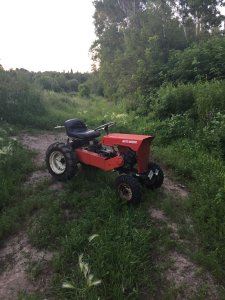

That’s mechanically the same tractor as my moto mower 6020.
Here’s a picture of the ol girlView attachment 8197
Nice tractor Greasy! Most definitely can see the similarities to the Executive. Would you share how you made the axle seals?
Thanks---DAC
Cardboard:p
Took seal retainers off, used them as pattern to trace and cut od, took hub off n used it to make hole for axle by tapping with smallest hammer I could find.
I doubled it up, 2 seals each side. Doesn’t leak anymore
Memory is fuzzy, and I’m kinda tired
Cardboard:p
If it works, that is what counts! Cardboard is a lot cheaper than the seals! Thanks for the tip!
