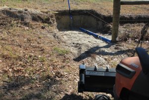

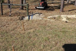

I'm finishing my horse fence (Bekert), the last 32 feet to the house. 32 feet and 5 foot elevation drop, I'll be terracing the side yard with short concrete retaining walls and make the cuts with the JBJR. The pictures are the first days start to this project. There will be 3 "H" brace sections and on top, 1, 4 foot "H" brace with Black 4 foot man gate.

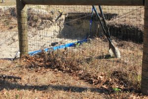

The blue level is 8 feet long and has been invaluable in all sorts of projects, and here it shows level.
