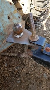

Multi Purpose Hitch Plate
I have a draw bar similar to that on my Sears 3pt, bad part is the flat pin part sticking out catches on the hitch of my ball trailer. Then I raise the 3pt so it's at an angle which doesnt help, yours should be fine
I have a 3 point on my Mtd990. I know some put a combination of hitches like a ball, pin, & hooks on the draw bar. My concern is how much side pull this creates on the lift arms to the point of breaking the tabs on the axle housing. I know the chains I think if adjusted properly are suppose to prevent side pull or lateral movement.
