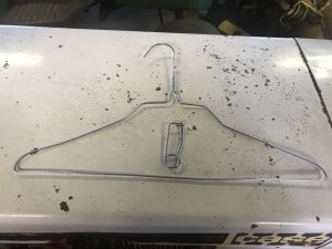

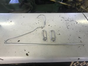

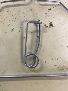

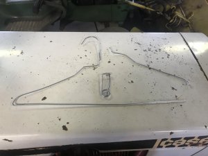

For my Case snow caster to hold the lift arm on. So figured I’d never find one to buy, so my super genius mind figured I’d make one.
Used a coat hanger, measured the old one quick and cut out what I figured was enough. Bent the hook end, then wrapped the coat hanger around a 1/2” copper water pipe, then cut the excess of the straight end. Only cut of an inch or so. Worked out great. Lots of spring in it to keep it locked in. These clips are used on the Case mower decks too. Took less than 5 minutes to make.
