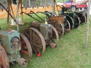

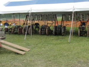

We managed to get 5 of the 12 known New Britain tractors together at the Plainfield WI show a few weeks back. These were built by the New Britain Tool Co back in 1919/20.

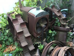

I think the number can be raised to 13, but the status on this one is sketchy and possibly in danger. My dad was planning on checking into this afternoon if its still there, which is how I wound up here looking for information on what it actually was.

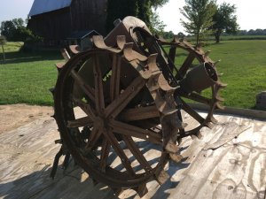

Thank you for the response Dougt, and I have some good news. The tractor is safe at its new home.
This was an odd deal all around, there was a local auction coming up this Tuesday where it was a hoarder that started collecting junk in an old elevator. Village took the guy to court on it and apparently was forcing him to clean up his mess, forcing the auction to sell everything in one big lot. The guy that owns the place was scrambling to move stuff off the property before the sale, and this tractor happened to be in that mess. This was in Mulliken Michigan (just west of Lansing), we live not to far from there.
Its a bit rough, but for something a century old its doing okay Wheels are rotted through on the left side, right side is mostly solid but has a few spokes that don't make it to the rim. Both rear casters are missing but should be to hard to come up with some small cast wheels to fix that. Most of the important stuff is there, radiator, mag, carb. No handles though, but again nothing an afternoon of tinkering couldn't solve. All in all not too bad.
After getting that thing wrestled on to the trailer I can't imagine what wrangling one around a field must have been like. It is by far no David Bradley.
Had a small question, what is that gear coming out of the belt pulley gear box on the right side of the tractor? Its right snug up in the wheel to the point I thought it would hit the spokes when we tried to roll it.
Edit: uh oh, hope thats not a drive sprocket and the rings missing of that wheel.

Congrats on getting number 13. Must be your lucky number. I don't see the bracket for the handles. The gear sticking out should be the drive gear for the wheel. That will be a shame if all that drive assy is gone. Maybe the previous owner would know where they are? I'll try to get you some pics. I'm setting up a new computer and haven't got things switched over and working yet. Probably easier to just take more.

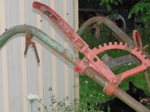

Managed to get a few moved over. This is the bracket that holds the handle bars. The shiny piece doesn't belong. nbhandlebrkt.JPG

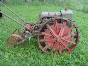

Here is a right hand view. You can see the drive gear assy from the outside.

This is the implement lift assy that mounts on the handlebar.

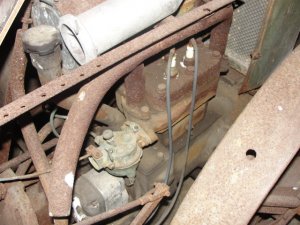

The Kingston 4 ball carb was original

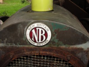

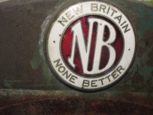

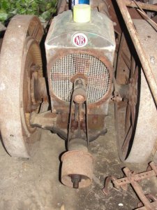

The radiator emblem.

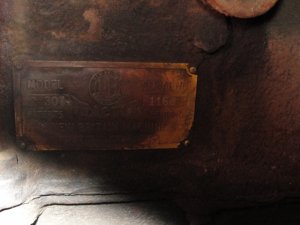

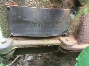

Only one of mine has the tag.
Thank you for those pictures Dougt that helps explain a lot. That drive assembly is one impressive piece of cast, which unfortunately is likely lost to time for ours. We were spit balling ideas on how to get it mobile again this afternoon and may have a few ideas on ether replacing the ring drive with something else or even possibly having a new one water jetted. First things first though will be just slowly working at getting casters under it, then picking away at the motor to get it free and running. That handle mount is much more complicated than I would have guessed and that's going to take some thinking to replace. From your pictures it looks like there may be a replacement mag on this one which they grounded 2 of the spark wires off to the frame that weren't being used. Would have thought a mag wouldn't need a load on wires it was not firing but maybe? It looks like at sometime in its past someone spent a bit of time getting or trying to get it going again. Seems like a long road ahead but should be fun to try and bring it back from retirement.

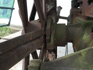

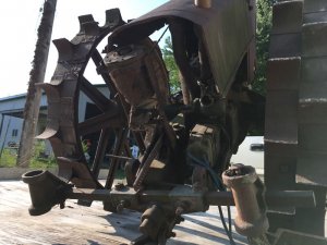

Thank you again Dougt, and apologies for not getting back sooner. A copy of the manual would be amazing! This is what is left of the hub/break assembly on the tractor:
I'm not 100% sure on this, but from what I can tell at some point in the machines past life it looks like someone tried to maybe get the wheel off and gave up. You can kind of see a few of the bolt heads in the crack of the hub being half turned out. I wonder if when they couldn't get the wheel off if they then just torched off the drive gear to get the wheels free to move it. Who knows I guess. Looks like any options forward though on getting the hub to work will involve a lot of heat and some very careful and gentle hammer taps.
