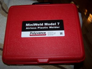

New Plastic Welder

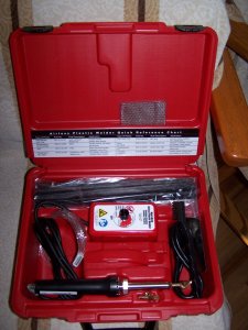

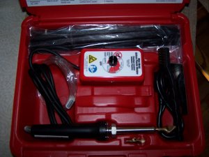

I bought a similar plastic welder to repair a large gouge in a zero turn fuel tank that also punched clean through a 3/8" hole. First I used plastic from the very thick tank to fill the void, then melted into that with stainless steel screen in the kit. Then covered with more plastic from tank. After that I used matching black kit supplied plastic sticks and it ended up really nice and zero leak. It's a cheap kit, so may end up buying a higher end kit one of these days. VERY satisfied with plastic welding. I used to just use a soldering iron to seal up leaks, but these kits are way better.
